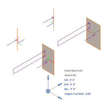

Load Orientation
The orientation of loads is aligned to the project base point and its orientation settings.
The Y axis orientation for forces is aligned with the N/S orientation, the X axis is aligned with E/W and the Z axis is aligned with the Elevation.
Rotating the project north will change both the orientation of analytical elements and the orientation of loads. If you change the orientation of the analytical elements, the position of the loads will not be updated.
