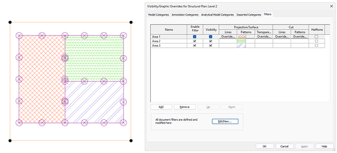

Area Loads Surface Representation
You can customize the area load surface Visibility/Graphics settings.
Use filters to identify each area load boundaries in a plan view, based on the loads parameters.
