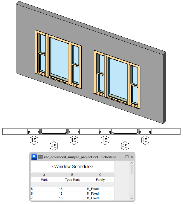

When you nest and share families, you can schedule shared families as individual instances. A family comprised of shared and nested families allows each instance of a nested family to schedule separately. Within the schedule, you can renumber each instance of a nested family.
Family comprised of 2 shared window families loaded into a project
If a nested family contains multiple categories, each instance of a nested family displays in its respective schedule and all components will display on a multi-category schedule.
