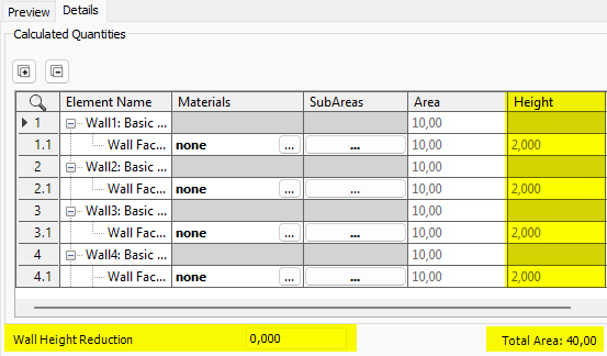

By default, Wall Height Reduction is set at 0, meaning that no wall height reduction is applied.

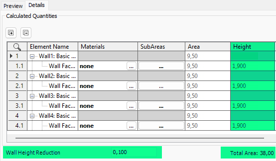

Enter a value to reduce the wall height. In the following example, the wall height is reduced by 10 centimeters. Click anywhere outside of the Wall Height Reduction to see the calculations adjust.
Note: Wall Height Reduction is applied to all selected wall surfaces of the room.

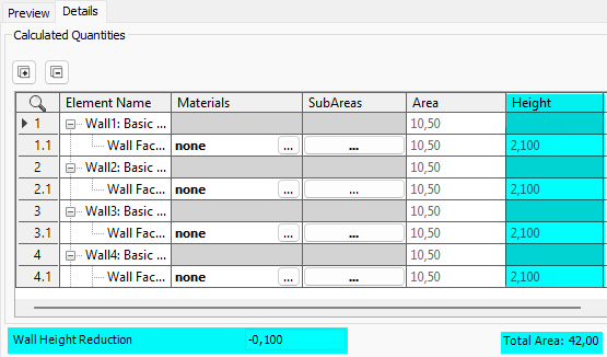

Enter negative integers to increase wall height, such as the case of recessed ceilings. In the following example, the wall height is increased by 10 centimeters.
