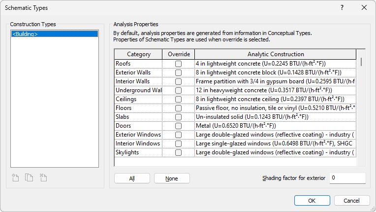

  3. In the Advanced Energy Settings dialog, for Schematic Types, click in the Value column, and click .
    The Schematic Types dialog displays the list of element categories, with the Override checkbox cleared for all categories.
  4. In the Schematic Types dialog, do the following:
    1. For a category for which you want to use thermal properties defined by schematic types, select Override. In the Analytic Construction column, use the drop-down list to select the desired construction.
      Note: To select Override for all categories, click All. To reverse it, click None.
    2. To continue using thermal properties defined by conceptual types for some categories, clear their Override check boxes.
    3. Click OK.
When you next perform energy analysis, thermal properties for the specified schematic types (analytic constructions) are used for those element categories.
