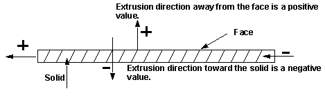

    The extrusion of a roof can extend in either a positive or a negative direction along the plane perpendicular to the face of a solid component (such as a wall).
    You can edit the start and end points using the roof instance properties.
