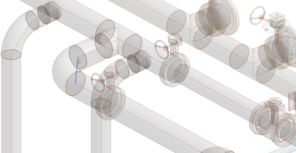

Analytical Pipe Segments are sub-elements of pipes, pipe fittings, pipe accessories, flex pipe, and mechanical equipment. They represent flow path in a pipe network. Analytical segments for fittings that contain more than two connectors will have multiple segments connected to an intersection point in the fitting. Use the Visibility and Graphics controls to enable the visibility of analytical segments in a view. To select an analytical pipe segment, use tab-select.

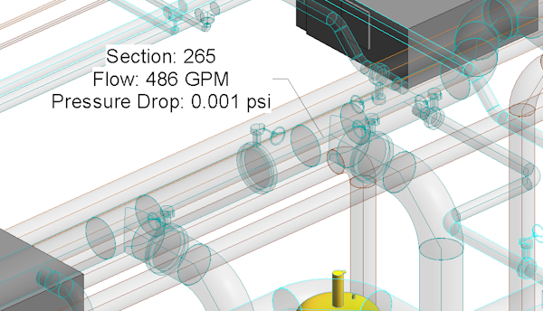

Create Analytical Pipe Segment tags to display the details of the network calculations for a single segment. This can be used as an alternative to System Inspector, particularly for fabrication pipe networks.

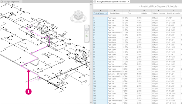

Create an Analytical Pipe Segment schedule to show flow and pressure drop parameters for each section. Filter the schedule by Network ID and Critical Path to highlight the critical path of a pipe network when selecting elements in the schedule. When selecting elements in a schedule, they will be selected in all currently open views. To display only the Analytical Pipe Segments, you can turn off the pipe element model categories in the Visibility\Graphic Overrides settings.
