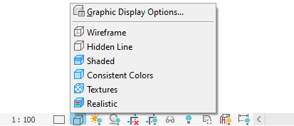

To specify a background for a 3D view, on the View Control Bar, click the Visual Style icon, and click Graphic Display Options.
