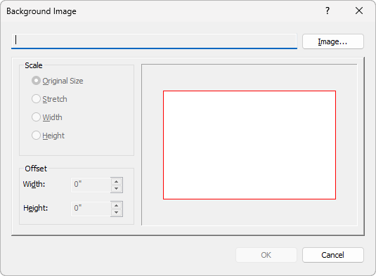

To specify a custom image
  1. In the Rendering dialog, under Background, for Style, select Image.
  2. Click Customize Image.
  3. In the Background Image dialog, click Image.
  4. Navigate to the location where the image file resides, select the image, and click Open.
  5. In the Background Image dialog, specify Scale and Offset, and click OK.
  6. Continue to define other render settings.
