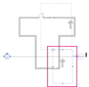

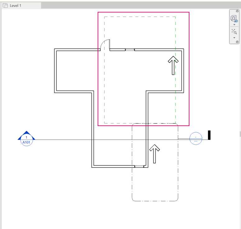

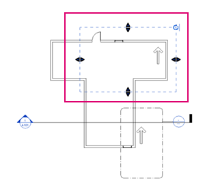

  2. Select the section (callout) or scope box. The upper line of the selection displays a rotation shape handle placed in a corner.
    Examples:
    Selected callout
    Selected scope box

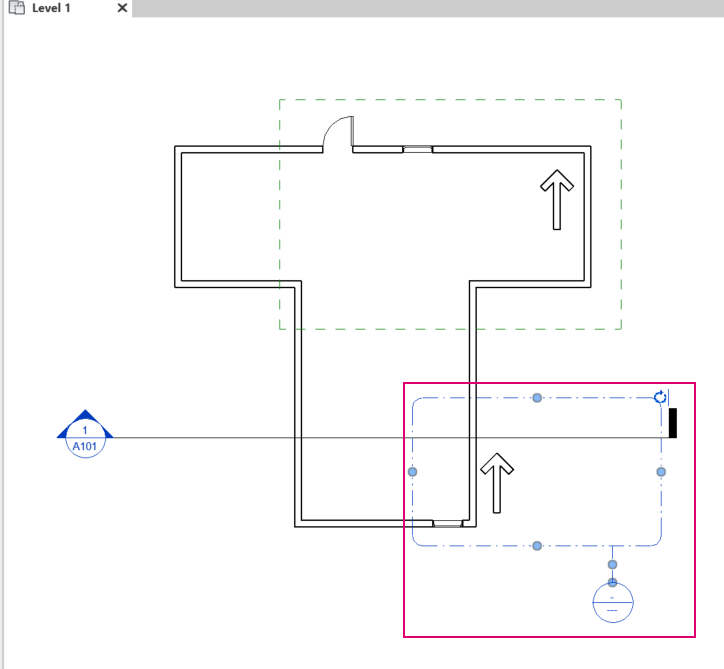

  3. Click Modify <view type> tabModify panel (Rotate).
  4. Rotate the selection. This action impacts the view only, not the elements inside it.

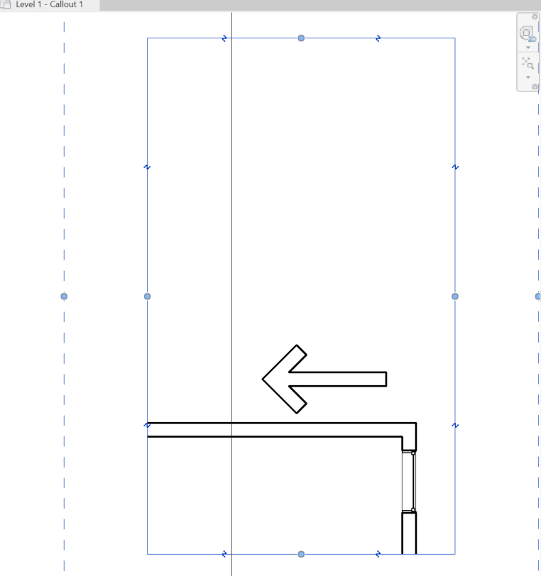

  5. In the callout or scope box project view, the cropped region is displayed with the top of the selection at the top of the screen.
    Example: Views after rotation with 90 degrees
    Rotated callout displayed in the project view where it was created
    Rotated callout displayed in the Callout view

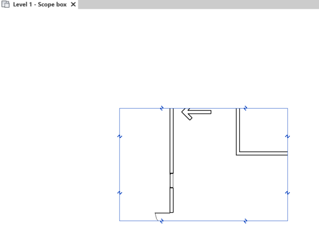

    Rotated scope box displayed in the project view where it was created
    Rotated scope box displayed in the Scope box view
