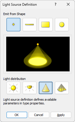

The Light Source Definition dialog displays.
- For Emit from Shape, select the shape of the light to emit from the light source: Point, Line, Rectangle, or Circle.
- For Light distribution, select the pattern of light distribution for the light source: Spherical, HemiSpherical, Spot, or Photometric Web.
Tip: If you plan to specify an IES file to define the photometric shape of the light source, select Photometric Web. Note also that because IES files are based on specific fixtures, for best results, place the light source below the fixture opening, and ensure that it is not touching the fixture geometry.
The middle image changes to illustrate the combined settings. These settings determine the parameters that are available for the light source.
- Click OK.
The outline shape for the light source may change in the drawing area, depending on the selected light source definition settings.
