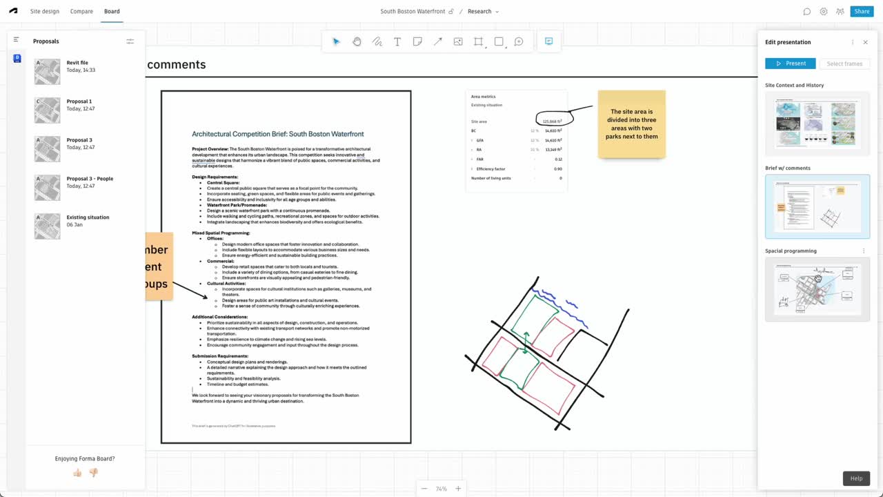

  1. Navigate to Forma Board:
    • Access Forma Hub > Project > Site > Board to start your collaborative project.
  2. Bring in Files from Docs by using the left panel:
    • Retrieve and pin files from Docs, including Revit proposals, sheets, and analyses created in Forma Site Design. Note that you can add analyses in both static and live states-static analyses remain unchanged, while live analyses update in real time.
    • Drag and drop content onto the canvas. Use frames to stay organized and move content in bulk.
  3. Collaborate with Your Team using the tools at the top of your screen:
    • Use markup features such as pen, text, arrows, shapes, and sticky notes to annotate your content.
    • Tag your colleagues in comments-they'll receive an email notification-to gather feedback and foster collaboration.
  4. Present Your Work:
    • Use the presentation mode to showcase your work effectively.
    • Share your board with others to collaborate and provide input.
