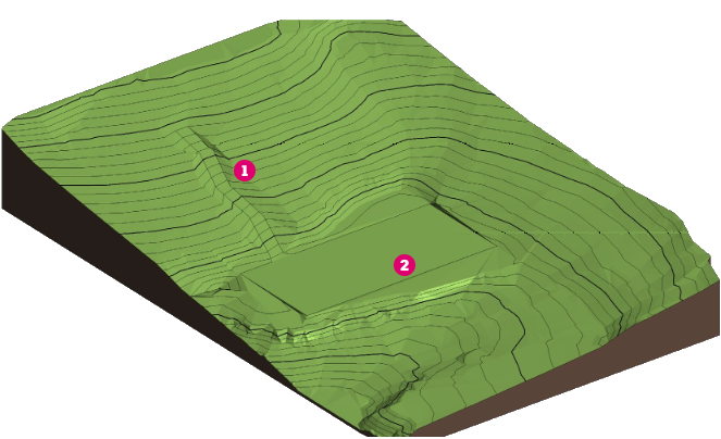

For example when working with a toposolid, place split lines along the surface to create a path way
, or place split lines at an absolute elevation to create a flat area
