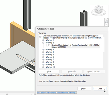

  3. A warning message will appear stating what happened and the steps that you need to follow to solve this issue:
    "One or several analytical elements have incorrect geometry, but their physical associated elements are correct. You can recreate the geometry of the analytical elements by remodeling them based on their physical counterparts."
To recreate the missing geometry and resolve the warnings:
  1. In the Manage tab Inquiry panel, click (Review Warnings).
  2. In the Warnings dialog, click the plus sign next to the warning message regarding the model upgrade to expand the list of individual warnings.
  3. Click the plus sign next to each of the individual warnings to see more information about the elements.
  4. In the Warnings dialog, select one of the warnings, click the plus sign and select the element information.
  5. Click the Show button in the Warnings dialog to highlight the selected element in the model.
  6. After identifying the element (e.g., a wall) close the Warnings dialog.
  7. Select the identified element (e.g., the wall) and in the Analyze tab Structural Analytical Model panel, click (Analytical Panel).
  8. In the Modify | Create Analytical Panel tab Work Plane panel, click (Set).
  9. In the Work Plane dialog, select Pick a plane and click OK.
  10. Select a plane in the model.
  11. In the Modify | Create Analytical Panel tab Draw Panel, select one of the drawing methods (e.g., rectangle) and draw the analytical panel based on the shape of the selected element (e.g., wall).
  12. Click (Finish) to create the analytical panel.
  13. Select the analytical panel.
  14. In the Modify | Analytical Panels tab Coordination panel, click (Add Association).
  15. Select the element (wall) to associate the analytical panel with in the model. An association between the physical and analytical element will be created.
    Note: To check the association, select one of the two elements (the wall or the analytical panel) and click (Highlight Association) in the Modify | Analytical Panels tab Coordination panel.
  16. If you go back to the Warnings dialog in the Manage tab Inquiry panel and click the plus sign next to the warning message regarding the model upgrade to expand the list of individual warnings, you will see there is one less warning item in the list - it was resolved and deleted from the list.
  17. Do the same for each of the elements displayed in the warning message list.
