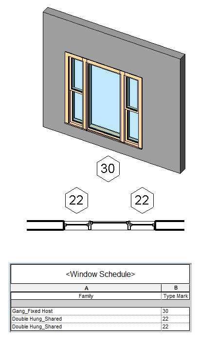

When the ganged unit shown above is loaded into a project, tagged, and scheduled, the result is as follows:
Nested and shared families loaded into a project
Notice the double hung windows are tagged and scheduled separately. The fixed window that was the host is not included in the schedule and not tagged. However, notice the ganged window name, Gang_Fixed Host, is listed with the subcomponents. This window represents the main window composed of the of the 3 subcomponent windows.

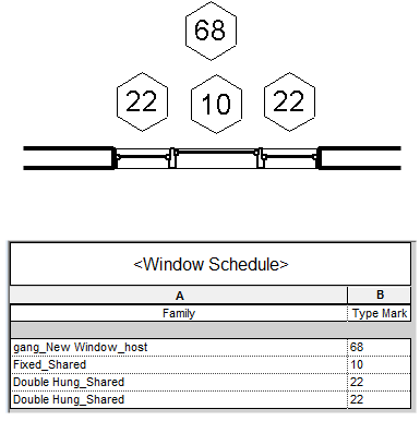

In order to get both the fixed and double hung sub-component windows to tag and schedule, the same triple window family was created, but this time a new window family is used as the host family and both the fixed window and the double-hung windows loaded as shared families. Notice the difference in the tagging and scheduling.
Ganged window family started as a new family
In the example shown above, notice the host family schedules with each of the 3 subcomponent windows. If this is not your design intent, you should follow the previous example, where one of the subcomponents is the host family.
