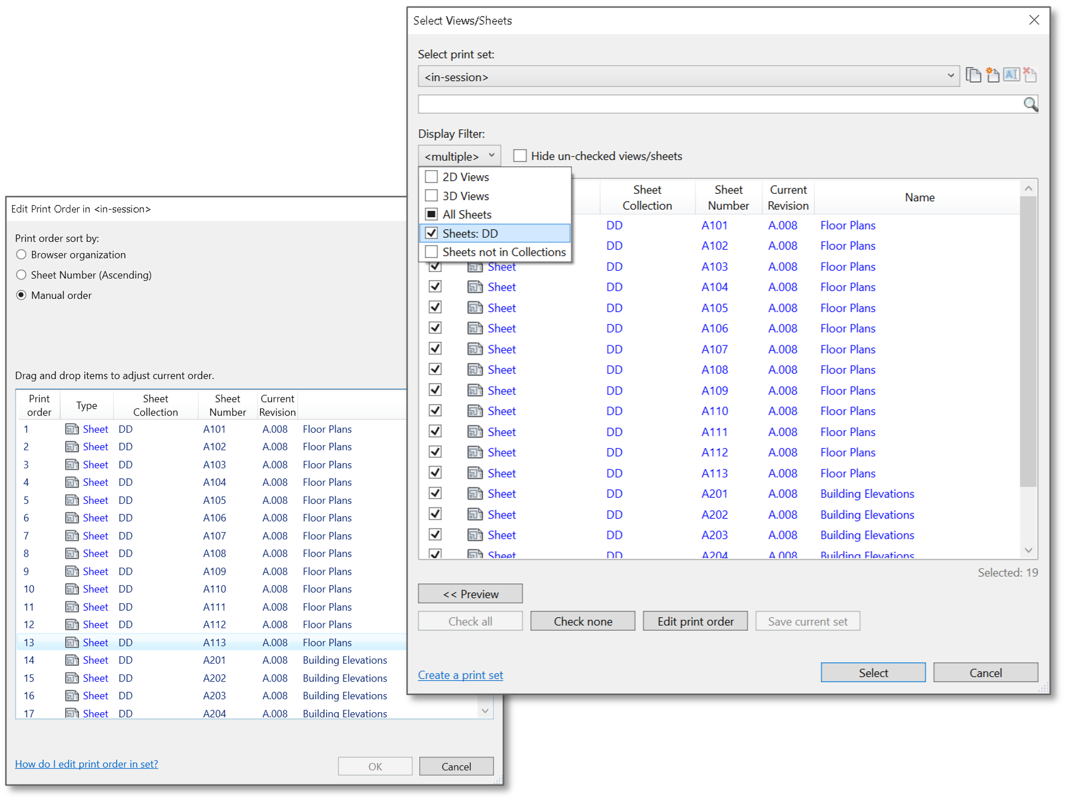

View and sheet selection is easier with additional columns for sheet collection, sheet number, and current revision included in the dialog. PDF exports have been improved so they are faster and more accurate.
Print/Export Sheet Selection
The "Select Views/Sheets" dialog box has been updated to incorporate columns for Sheet Collection, Sheet Number, and Current Revision information. Utilize these columns to effectively identify and select the desired views and sheets for inclusion in your output.
