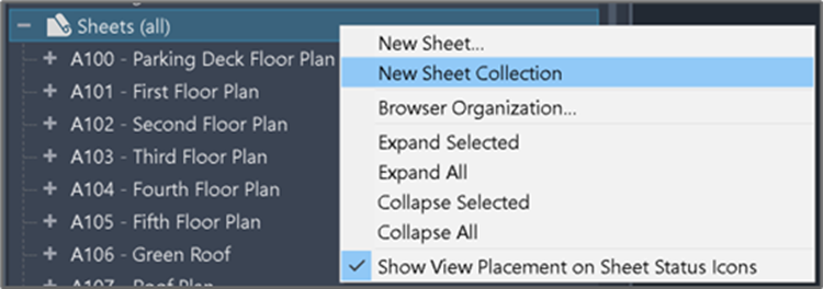

With the Sheet Collections feature, you can assign any sheet in the model into flexible groupings.

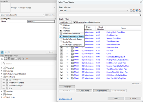

This supports custom organization that can be referenced across Revit (such as in views, schedules, families and filters).
The parameters Sheet Collection and Referencing Sheet Collection are available to compatible view types in Revit, alongside the existing sheet and view parameters.
The Export\Print dialog includes each Sheet Collection as a dedicated display filter toggle, to support precise selection of sheets in one or more collections.
