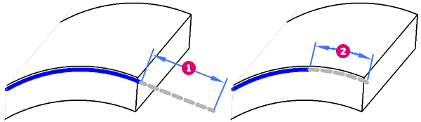

Directly editing free form rebar instances and rebar sets removes constraints to the host. This includes copying, moving, rotating or mirroring rebar as well as adding the bars to assemblies and groups. Rebar that loses constraints no longer responds to changes in the geometry of the structural element.
, while shortening occurs along the curve
