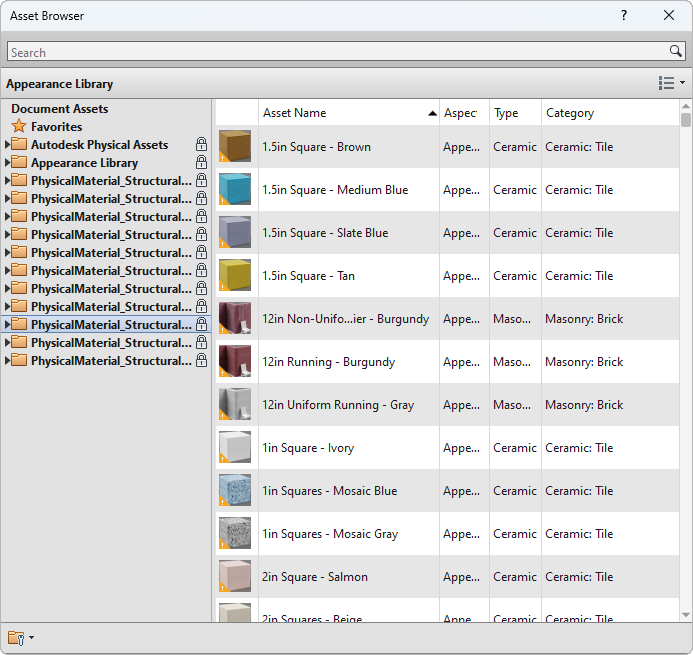

  3. To select an asset for editing, in the Asset Editor, click (Opens/Closes Asset Browser).
    The Asset Browser opens.
    In the asset list, the icon indicates legacy appearance assets. For details, see About Appearance Assets.
    Tip: Use new appearance assets (without the icon) for materials. This practice ensures that views and rendered images use the most up-to-date, highest quality representations of materials.
  4. Right-click the asset to edit, and click Add to Editor.
