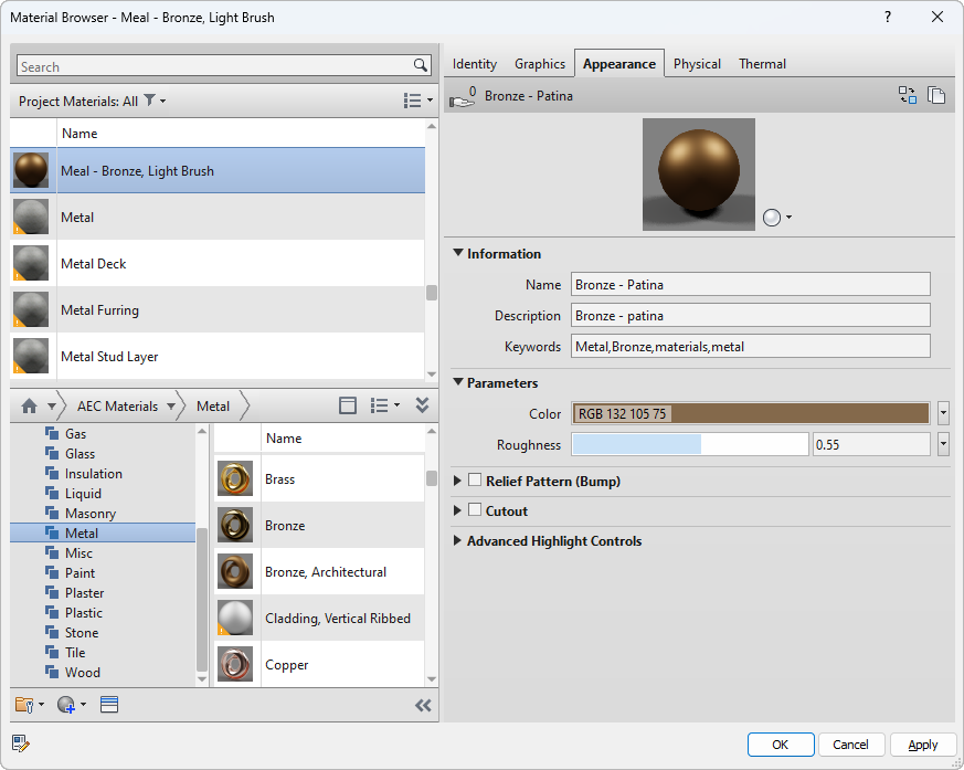

The following figure shows some of the appearance properties for a selected material, as displayed in the Material Browser.
The appearance properties are grouped in one "asset" of the material, and are managed on the Appearance tab. Other assets associated with the material are managed on the corresponding tabs. Each asset can be changed independently when you edit a material that exists in a project.
Note: Some materials may display the icon on the thumbnail. These materials use legacy appearance assets. If a new appearance asset is available, replace it for improved rendering.
