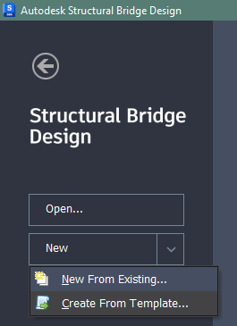

To start a new project (or design section or design beam) based on a template, either click on the New drop down button | Create From Template from the Home screen,
or File | New | Create From Template from the main menu.
