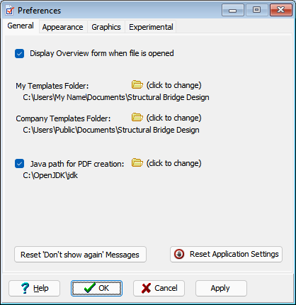

This form is used to modify preference settings for the program and is accessed through Options | Preferences in the main menu.
Preferences are set using the check-boxes and fields in each of the tabs.
Preferences are applied (and their effect observed) using the Apply button.
Preferences are saved using the OK button.
Form Graphic
Field Help
General
Display Overview form when file is opened
If this box is checked then an Overview form and Graphic is displayed on opening a new file.
My Templates Folder
Company Templates Folder
Refer to Using Templates for general information regarding templates.
Click on the folder button to change the template collection location.
Java path for PDF creation
This will show the path to the Java executable if installed. PDF reports can not be generated if Java is not installed.
To override tick the box and click on the folder button to change the location. This path will need to be manually set if using OpenJDK. Refer to the Java topic for additional information.
Reset 'Don't show again' Messages
Certain program messages have a 'Don't show me again' box to avoid seeing the message again. Click this button to reset all messages so they will appear again.
Reset Application Settings
To reset all application settings, e.g. unit preferences, form positions, history lists, etc., click this button and restart application.
