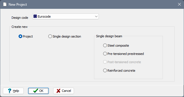

* The Home screen New button will show the following form. This allows the design code to be set before choosing either to create a new project (which can optionally contain a structure and one or more design sections and beams) or create a new single Design Section or Beam. The Design Beam availability will depend on the design code chosen.

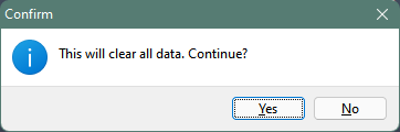

When a New command is selected from the Home screen or main menu, the program will clear all data and restore the program stored default values, after prompting the user to save data if any data would be lost.
This corresponds to the initial state of the program when it has just been accessed.
The prompt message issued is:
Select Yes, the program goes ahead and clears the current data.
Select No, the program returns to the open file with no further action.
