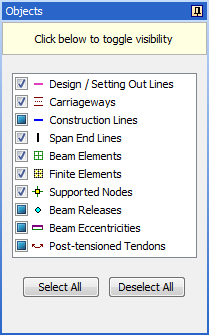

This side toolbar allows the user to select what types of object are visible in the graphic window.

Click on the Objects tab on the right hand side of the graphic window. This toolbar will fly out.
When no instance of an object type has been created then the checkbox alongside its description is greyed.
Hidden object types have an empty checkbox.
Visible object types are checked.
By default all object types are visible. They may all be hidden by clicking on the Deselect All button and they may all be made visible again by clicking on the Select All button.
Then check the checkboxes of those object types that are required to be visible.

Objects Toolbar Graphic
