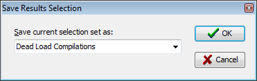

A selection of members can be saved for future use as a 'Member Selection Set' by clicking on Save (to bring up a 'Save Member Selection' sub-form), entering a name and clicking OK to confirm.

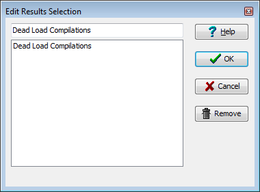

An unwanted member selection set may be removed by clicking on Manage (to bring up a 'Manage Member Selection' sub-form that displays all member selection sets), selecting a set and clicking on the Remove button (and OK button to confirm).

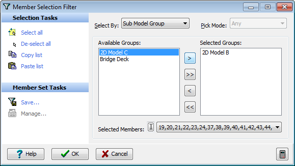

Select By
Selections may be made from specific sources according to the selection made from this field. The available options are:
| Item | Description |
| Point with Mouse | One or more members may be selected by pointing with the mouse in the display area and clicking with the left button to select a member. Selected members will be highlighted on the display. Members can be de-selected by setting the select mode to 'Remove'. |
| Mesh | When this is selected the left-hand pane will display a list of meshes that have been defined, identified by the name they have been assigned previously via the define mesh form. Drag a mesh group name from the left to the right-hand pane labelled 'Selected Groups'. The selected mesh will then be highlighted on the display. |
| Structure Property | When this is selected the left-hand pane will display a list of structure properties that have been defined, identified by the name they have been assigned previously via the Structure Properties form. Drag a structure property group name from the left to the right-hand pane labelled 'Selected Groups'. The selected structure property group will then be highlighted on the display. |
| Member Group | When this is selected the left-hand pane will display a list of member groups that have been defined, identified by the name they have been assigned previously via the assign section data form. Drag a member group name from the left to the right-hand pane labelled 'Selected Groups'. The selected group of members will then be highlighted on the display. |
| Sub Model Group | When this is selected the left-hand pane will display a list of sub model groups that have been defined, identified by the name they have been assigned previously. Drag a sub model group name from the left to the right-hand pane labelled 'Selected Groups'. The selected group of members will then be highlighted on the display. |
| Member Selection Set | When this is selected the left-hand pane will display a list of previously saved member selection sets. Drag a selection set name from the left to the right-hand pane labelled 'Selected Groups'. The selected group of members will then be highlighted on the display. |
If the structure contains a virtual member and Result For is set to 'Virtual Member' then only three options are presented:
| Virtual Member | When this is selected the left-hand pane will display a list of virtual members that have been defined, identified by the name they have been assigned previously. Drag a virtual member group name from the left to the right-hand pane labelled 'Selected Groups'. The selected virtual member will then be highlighted on the display. |
Pick Mode
Allows more discriminating selections to be made in a congested model when 'Select By' (see above) has been set to 'Point with Mouse'. Options are:
- Any
- Beam Element
- Finite Element
- Longitudinal Beam
- Transverse Beam
Available Groups
Lists all the Groups of members that match the current 'Select by' option. These can be dragged and dropped to the 'Selected Groups' pane, in which case their members are added to the 'Selected Members'.
Selected Groups
The current selection of groups from which the members have been added to the 'Selected Members'.
Selected Members
The current selection of members (or 'Member Selection Set'). Managed by the Assignment Controller, which allows selection from a drop-down list of all members or definition of a selection by text formula.

Save
Select this command to display the Save Member Selection sub-form. This allows a name to be defined for the current selection, which is then saved within this data file. The name becomes available for use as a member selection set in future filtering on clicking OK to exit the sub-form and confirm.
Manage
Select this command to display the Manage Member Selection form.
The member selection set name may be modified by selecting the set (click on the set name in the list) and then changing it in the top field.
A selected member selection set may be deleted by clicking the Remove button. A warning is given.
Clicking OK confirms the changes.
