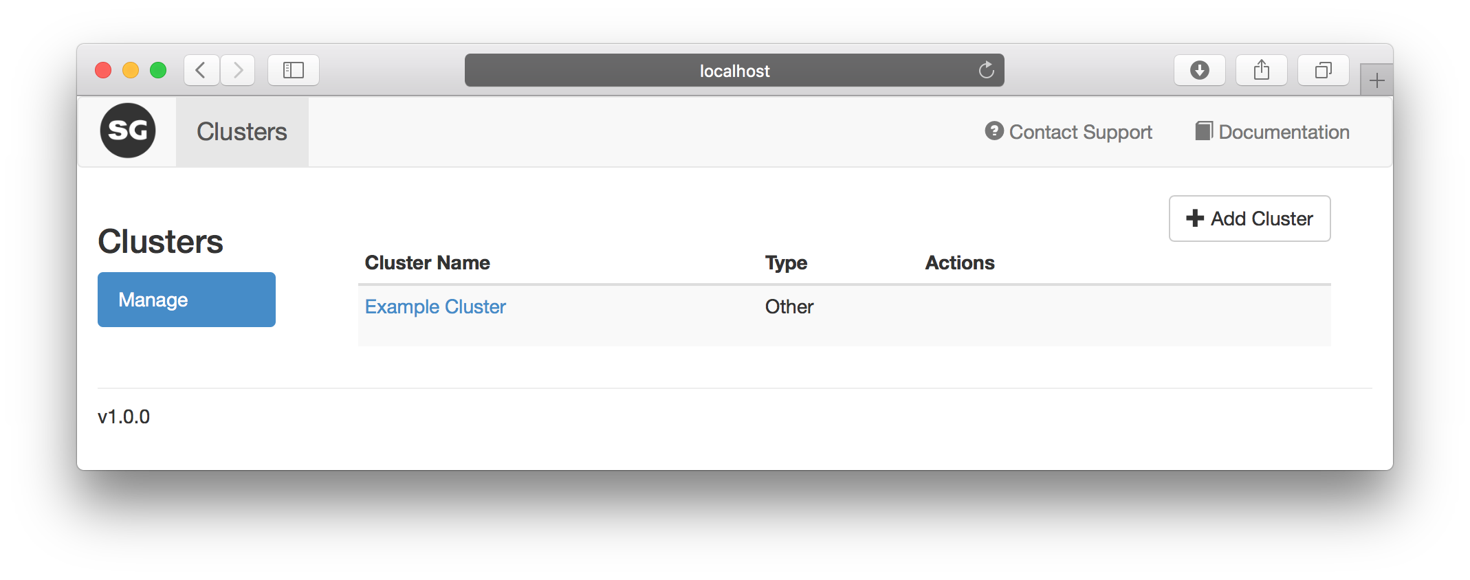

SEC main screen
Clusters can be added to SEC from the landing page of the application. To do so, SEC needs to be able to access the URL used to communicate with the Docker agent. This can be over Unix sockets or a TCP socket.
Details on how to setup docker to connect to different socket types is available on Docker documentation.

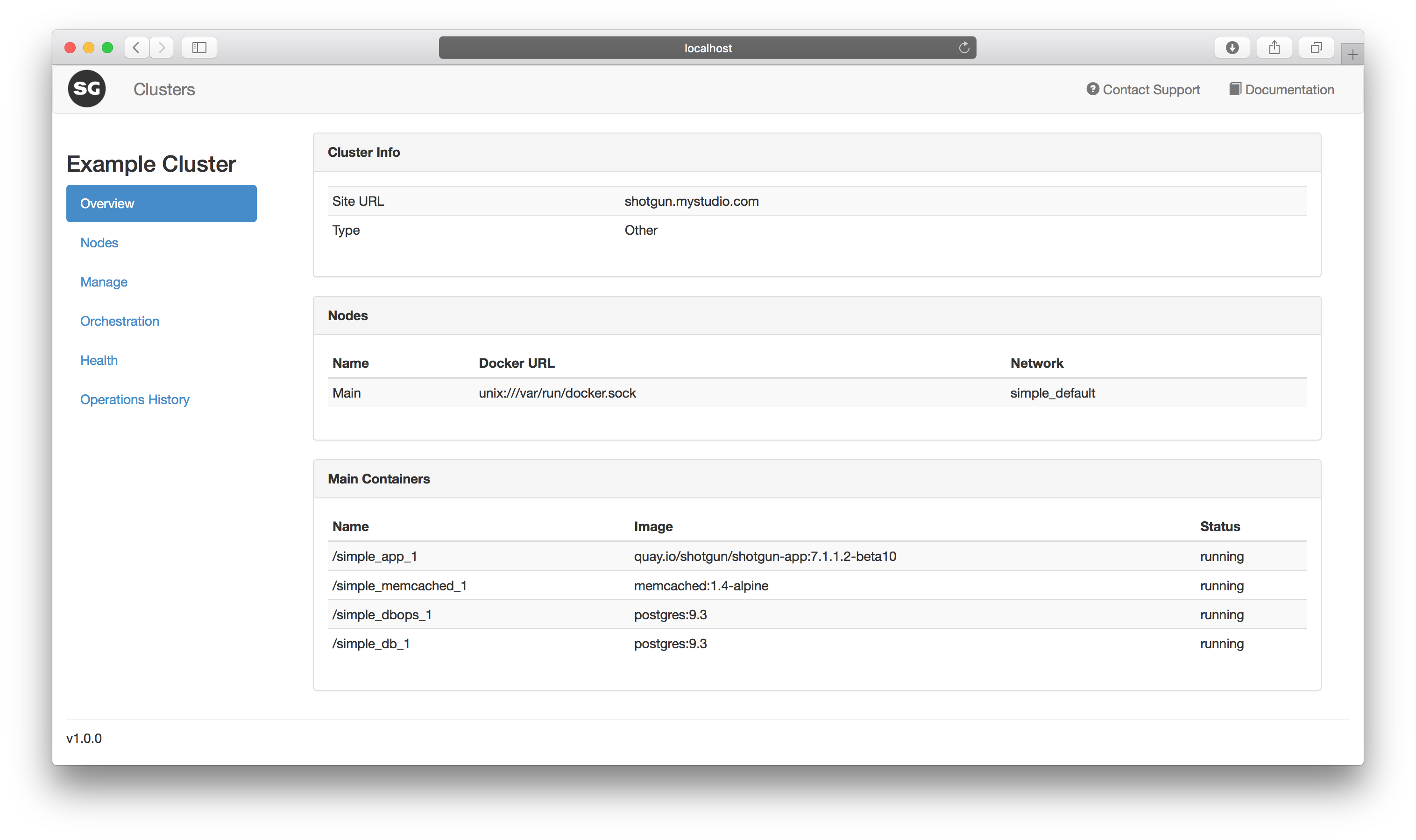

Cluster management
SEC cluster overview
Additional nodes can be added to a cluster from the Nodes section. This will allow running different components on different servers if required, or scaling up various components in cases where performance is a consideration.
SEC provides easy access to commonly run commands used by Flow Production Tracking Administrators. These commands are available in the Manage section.
SEC also provides some basic checks and information on the Docker instances in each cluster. These are available in the Health section. The checks ensure that all components required for a running a Flow Production Tracking instance are present, and compares them to values stored in Flow Production Tracking Preferences.
