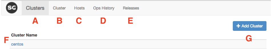

Home Page (Clusters)
The Home page is the main SEC entry point. It gives information about your Clusters.
A. Tab displaying all the clusters available. This is the home page. When you first use the SEC, no cluster is available. You must create one. See Creating a Cluster for more details.
B. Tab displaying details about the current cluster.
C. Tab displaying information about all servers in the cluster.
D. Tab displaying the history of all operations run in the SEC.
E. Tab displaying a list of all Flow Production Tracking Releases available.
F. Cluster list.
G. Allows addition of new cluster.

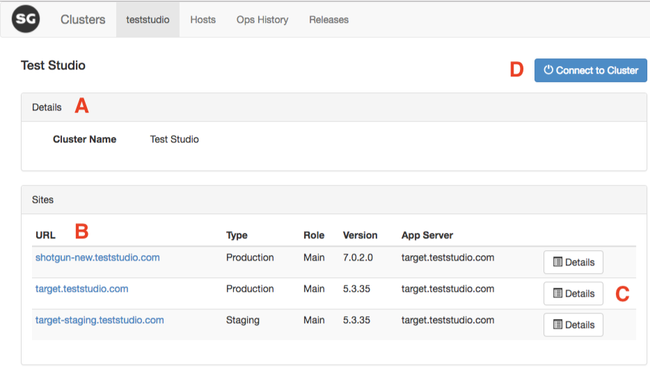

Cluster Details Page
The Cluster Details page provides contextual information about a cluster.
A. Cluster Details.
B. Information about available sites.
- URL: Site url. Selecting the site will open a browser at the site URL.
- Type: Production.
- Staging or Dev.
- Version: Current Flow Production Tracking version.
- App Server hostname.
C. Additional details about a cluster/site, and the entry point to operations. See Site Details Page.
D. Connecting to a Cluster allows operations to be executed on it.

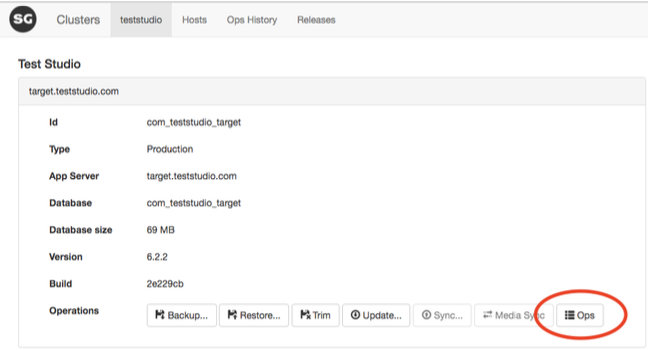

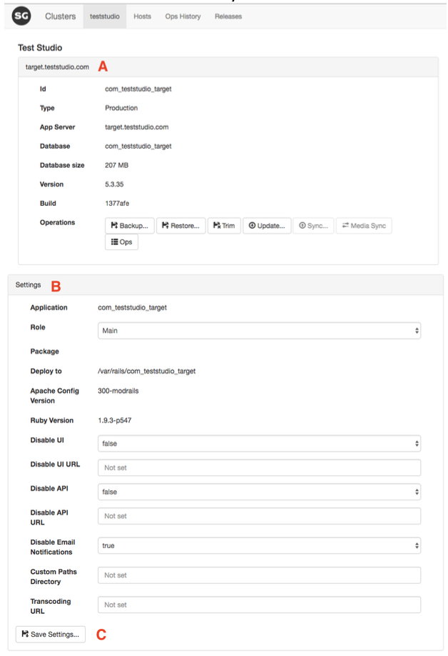

Site Details Page
Accessible through the Cluster Details page, the Site Details page allows operations to be executed on a site. It also exposes some configuration options that are editable. The settings section is for advanced users only.
A. Site information and operations.
B. Cluster settings. These are advanced options which should usually not be modified. Hover over the settings label in the UI to have more information about some settings.
C. Persist settings. Settings are stored as JSON and represent a site configuration. For settings to be applied to a cluster, the site usually needs to be redeployed.

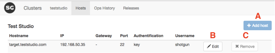

Hosts Page
The Hosts page gives information about all hosts in a cluster. It also gives you the ability to modify/add new hosts to your cluster.
A. Add a new host to the cluster.
B. Edit the properties for a new host.
C. Remove a host from the cluster.

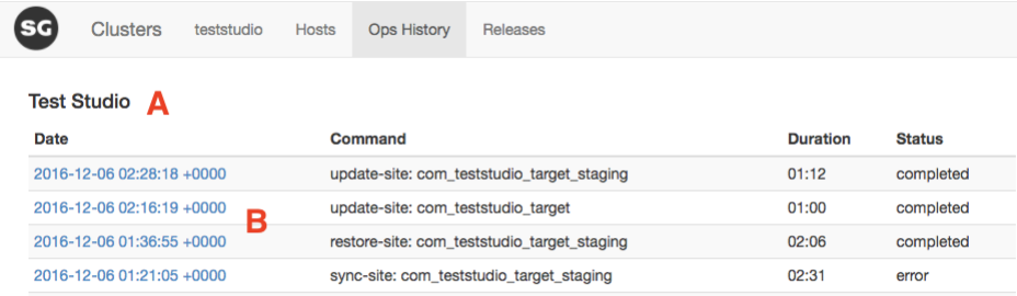

Operation History Page
The Operations page lists operations history. All logs for past operations are available for consultation.
A. Operation history.
B. Selecting an operation will give more details about the operation (status, duration, log).

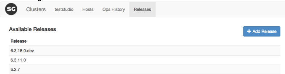

Releases Page
List the Flow Production Tracking releases available to SEC and allow to add new releases.

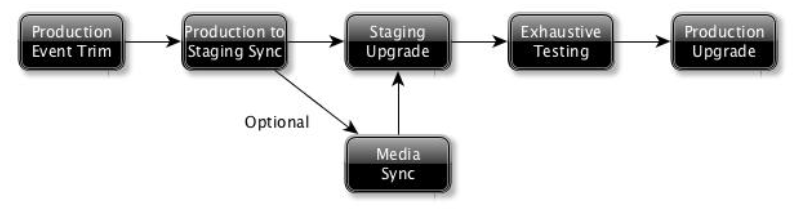

Suggested Workflow
Here is the suggested workflow that we highly recommend you follow when updating Flow Production Tracking. Using this workflow will help you minimize risks and get the best out of Flow Production Tracking.
- Production Event Trim. We suggest removing events older than six months. Always make a backup first, as we never know what can happen!
- Production to Staging Sync. Will sync your production data to your staging site. This will ensure your testing is as relevant as possible. This also makes sure that your data can be migrated without issues to a new Flow Production Tracking version.
- Media Sync. Optional step. Only needed if your testing requires the media to be available. Flow Production Tracking will work without thumbnails and media assets.
- Staging Upgrade. Update and test the latest features!
- Exhaustive Testing. To prevent any issues in production, we highly suggest you test all your common Flow Production Tracking workflows.
- Production Upgrade. When your testing is conclusive, update your production site.
