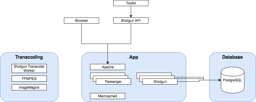

Flow Production Tracking is composed of four main components.
- App module: Receives requests from users and queries the database. The Flow Production Tracking application is powered by Apache and Phusion Passenger for Ruby on Rails. An app module can be specialized. The web module receives only requests from the browser, while the API module receives only requests from Flow Production Tracking integrations (Toolkit) and scripts using the Flow Production Tracking API.
- Database module: Contains all your Flow Production Tracking metadata and powers your queries. PostgreSQL is Flow Production Tracking’s DBMS.
- Object caching module: Memcached is used to cache results that are frequent and compute-intensive. Page schemas are the most heavily cached entities.
- Transcoding module: The transcoding module is built on top of FFMPEG and ImageMagick. It converts your media into a web-friendly format.

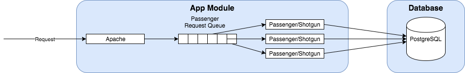

The Flow Production Tracking Application is instantiated through the Apache and Phusion Passenger stack running inside a container. Apache routes the requests to Passenger, which manages the instantiation of multiple Flow Production Tracking Application instances in order to allow the processing of multiple requests at the same time.
If no Flow Production Tracking processes are available, the request is queued. Each Flow Production Tracking process then makes one or more requests to the database, and the result is returned upon completion. If too many requests are made for the system, the queue will overflow and requests will be answered with a 503 error.

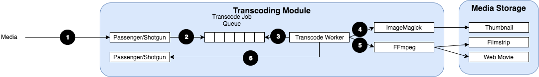

The transcoding module for a local install is a simplified version of our hosted transcoding service. A single worker, instantiated on demand by the Flow Production Tracking Application, executes all the transcoding for your site. This means that a maximum of one transcoding job is running at the same time.
ImageMagick is used to create thumbnails out of the media. FFmpeg is used to convert videos into a web streamable format. See Transcoding for more information about Flow Production Tracking transcoding.
Transcoding workflow
The Transcoding module is intended to be simple and may not be able to sustain your load. If you already have a transcoding or rendering farm in place at your studio, you may want to integrate this system with Flow Production Tracking. See Do it yourself transcoding for more details.
