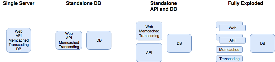

Flow Production Tracking Enterprise architecture
The paradigm used by Flow Production Tracking is that each component in the Flow Production Tracking solution is encapsulated in a container. This gives a lot of flexibility to Flow Production Tracking Administrators regarding how Flow Production Tracking is hosted on their Studio infrastructure. Containers can reside on the same of different hosts, and that topology can be changed very easily.
