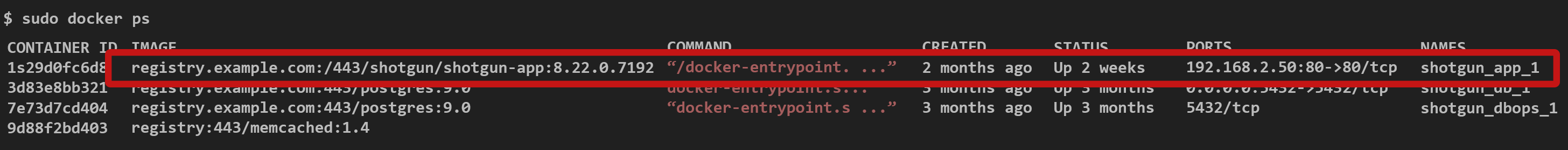

List all running containers executing the following command:
$ sudo docker ps
Find the Flow Production Tracking container name. In this case, the name is
shotgun_app_1

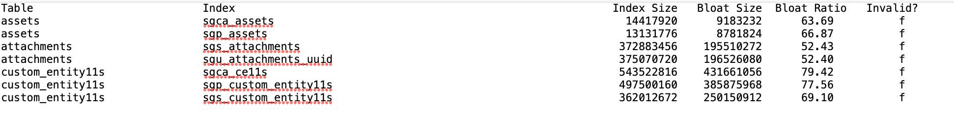

To list the bloated indexes execute this command. This command does not change the database.
IndexHelper.list_bloated_indexes
The output will list all the bloated indexes that should be rebuilt. The Invalid column is a boolean field (F == False). Invalid indexes cannot be used by the database. Invalid indexes normally appear when the command to create an index times out. Remove the Time Out and recreate the index.
