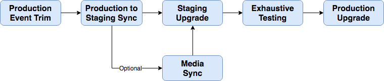

Flow Production Tracking update workflow
Here is the workflow that we enforce when updating Flow Production Tracking. Using this workflow will help you minimize risks and get the best out of Flow Production Tracking.
Planning
- Determine with your Production team when downtime would be acceptable. Plan for your staging upgrade to happen at least two weeks prior to that date. Sometimes, knowing how much downtime will be required is useful, so you may want to do the staging upgrade before planning production downtime.
Staging upgrade
- Production event trim - We suggest removing events older than six months. This can help improve Flow Production Tracking's performance. The database is backed up first. Also, trimmed events are kept available, in CSV format, allowing for later consultation.
- Production to Staging sync - We will sync your production data to your Staging site. This will ensure your testing is as relevant as possible. This also ensures that your data can be migrated without issues to a new Flow Production Tracking version.
- Media sync - Optional step. Only needed if your testing requires the media to be available. Flow Production Tracking will work without thumbnails and media assets.
- Staging upgrade - Update and test the latest features!
Exhaustive testing - To prevent any issues in production, we highly suggest you test all your common and critical Flow Production Tracking workflows:
- Performance regressions.
- Web UI, at least pages that you use the most.
- Critical production scripts.
- Integration to the different tools and DCCs you use.
Production upgrade - Once your testing is conclusive, we can confirm the production update time our Support Team scheduled.
