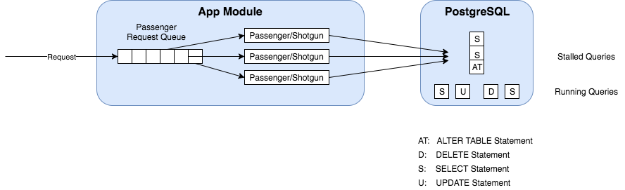

Adding new fields in Flow Production Tracking is a powerful feature that allows users to dynamically customize their Flow Production Tracking Instance data model.
This capability comes at a cost. In the database world, adding a field corresponds to adding a new column in a table (ALTER TABLE). The lock that needs to be obtained to add a field to a column is an ACCESS EXCLUSIVE lock on the table. This mode guarantees that the holder is the only transaction accessing the table in any way, including reads. Concretely, it means that once the field creation request is submitted, all previous requests on the table must complete before the field creation happen. This also means that all subsequent requests are blocked until the field creation is completed.
If a very long running request is in progress and a field is created, this could theoretically lead to a very long period where requests on that table are blocked. For a user, it would look as if the site is slow or unresponsive. To prevent this, Flow Production Tracking only waits for the acquisition of the lock for a small period of time, after which the lock request is cancelled, unblocking the subsequent requests waiting (lock acquisition timeout).
Identify blocking queries
If you really can’t succeed in creating a field, it’s probably because you have too many long running requests on the table on which the field is to be created. The lock acquisition timeout should be long enough so this situation cannot happen.
If it’s the case however, the best thing to do is to identify which queries are blocking the lock acquisition from happening. This article explains how to troubleshoot such issues.
