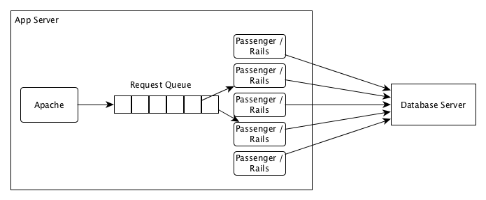

Flow Production Tracking architecture at a glance
At a very high level, Flow Production Tracking is composed of two main components:
- Application
- Database
Application - Containers inside which the Web Application Components are installed (Apache, Passenger, Rails, Flow Production Tracking App). Depending on your topology, you can have many application containers, specialized for serving the Web UI and API requests.
Database - The server on which the database server is installed. It can be the same server as the application server.
Requests are received by Apache and passed along to a Passenger process running an instance of the Flow Production Tracking Application. If no processes are available, it is inserted in a queue. Then, each Flow Production Tracking process passes requests to the database, and is returned upon completion. Each request to Flow Production Tracking usually results in many requests to the database.
