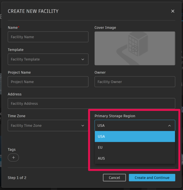

Data Residency
Tandem has the option to store their data in the EMEA region, Australia, or the United States. When creating a facility, users can choose where to host their information.
Please note the following important details:
  • Choice of Data Storage Location: Users can select to store their data in the EMEA region when creating a facility. Once a storage option is chosen, it cannot be changed. Users must carefully consider their choice as it is permanent.
  • Facility Transfer Restrictions: Transfer of facilities is only possible within the same region. Facility regions cannot change during transfer operation.
