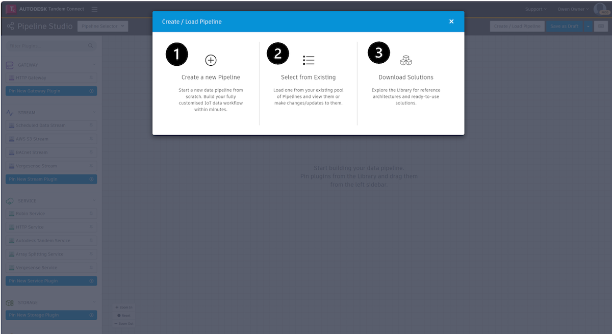

| Key | Description |
| 1 | Create a new Pipeline takes the user to Pipeline studio page to start creating a new pipeline. |
| 2 | Select from Existing lets the user select a pipeline from list of existing pipelines. |
| 3 | Download Solutions lets the user download pre-configured solution walkthroughs. |

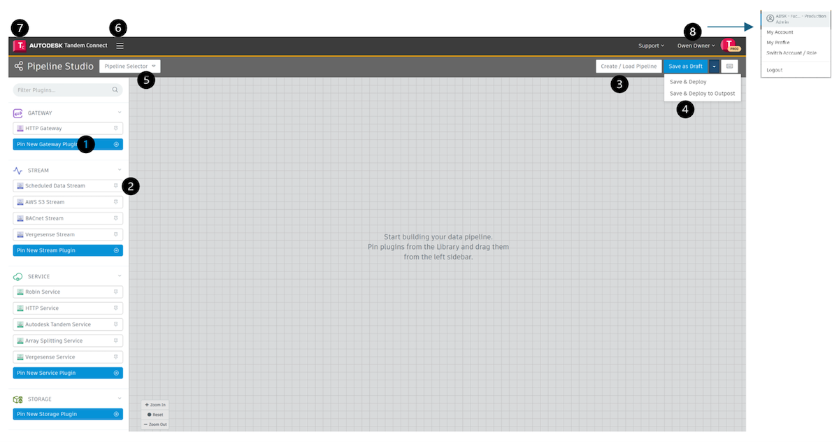

Pipeline Studio
| Key | Description |
| 1 | For easy access, pin the frequently used plugins to the left side panel menu. For ex: Click on Pin New Gateway Plugin and select the required plugin. |
| 2 | Click on the pin to unpin the plugin. |
| 3 | Create / Load Pipeline to start creating a new pipeline or load an existing pipeline. |
| 4 | To Save and Deploy the pipeline. |
| 5 | Pipeline Selector displays the different available pipelines to select from. |
| 6 | Provides access to main menu. |
| 7 | Click on Tandem Icon to go back to Home page. |
| 8 | Displays menu for account management. |

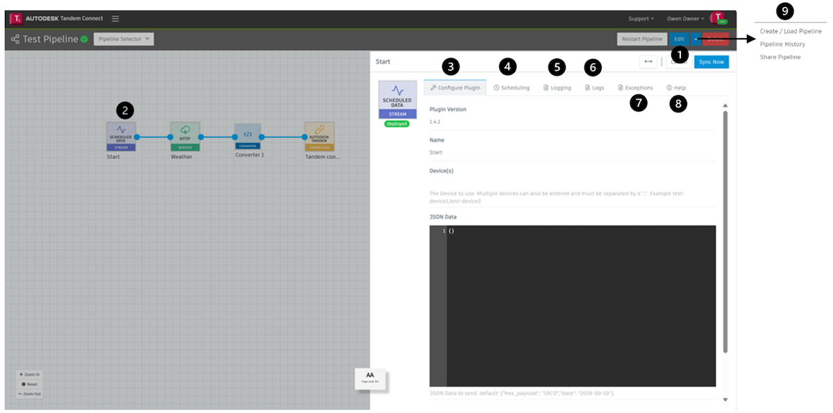

Pipeline Navigation
To create a pipeline, drag and drop the plugins, connect them together, and save and deploy.
| Key | Description |
| 1 | Click on Edit to start editing the pipeline. |
| 2 | Double-click on a plugin to open the configuration window. |
| 3 | Configure the plugin with the required values. |
| 4 | Schedule the frequency with which plugin will sync data (Note: scheduling is available for Stream plugins) |
| 5 | Helps to select user defined logger tools. |
| 6 | Click on Logs to view and download associated logs. |
| 7 | Click on Exceptions to view and download any errors that might have occurred. |
| 8 | Click on Help to view detailed documentation on how to configure the plugin. |
| 9 | Provides options to view pipeline history and share the pipeline with your team. |

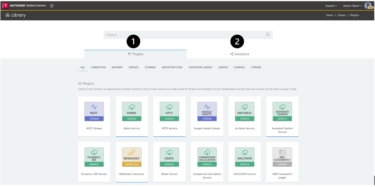

Library
From the Home Page Click on Library.
| Key | Description |
| 1 | Plugins display the list of all available plugins and their categories |
| 2 | Solutions tab displays all available pre-defined Solution Templates |
