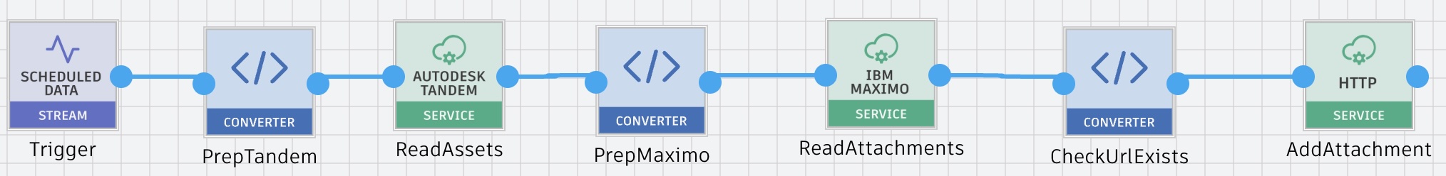

Scheduled Data Stream - Trigger
The scheduled data stream is the starting point in the integration which allows users to configure the user-defined property mapping between Tandem and Maximo applications. A pre-defined JSON is provided (in Appendix below) which can be copied and edited as per requirement. The mandatory parameters that need to be configured in the scheduled data stream are:

Detailed Solution Overview
This section details all components involved in the solution pipeline, including their configuration and purpose.
The scheduled data stream is the start of the pipeline where we can configure a schedule to determine how frequently it should run and update the properties. The plugin provides a way to mention the client-specific properties from Maximo as a JSON object. The JSON object provided in the Appendix can be copied and edited as per the client configuration.
Autodesk Tandem Service
The Tandem service is configured to read assets from the Tandem Facility. The asset filter and the attribute filter are
sent as overrides from the convertor prior to this plugin. The plugin reads all assets under the Category configured in
the scheduled data stream and applies the filters to read only those assets that match the criteria. The tandem service
itself prepares the Asset URL for each asset in the Tandem facility.
IBM Maximo Service
The maximo service plugin takes the data received from the previous convertor plugin which contains the oslc.where
filter along with the oslc.select attributes to read the assets matching the filter and also load the attachments for
the assets.
Convertor
- Prep Tandem: The JavaScript code that prepares the
AssetsFilterandAttributeFilterfor the Tandem Service Plugin based on the configuration in the scheduled data stream. - Prep Maximo: Based on the data received from Tandem, this convertor prepares the
oslc.whereasset filter for the Maximo APIs. The key is theoslc.selectwhich contains the"assetid, assetnum, doclinks{*}",and theoslc.wherewhich is a dynamic value that is set using the list of asset numbers received from the Tandem service plugin. This filter is then sent to the Maximo service plugin to read the assets.
Check URI Exists
The convertor checks if the Asset URL generated by the Tandem service plugin already exists in the attachments that
are loaded for the asset in Maximo. If it does not exist. If the incoming Asset URL does not exist in the attachments,
the convertor creates HTTP POST body to add the attachment to the Maximo asset. The HTTP POST body is then sent to the
HTTP service plugin to add the attachment to the Maximo asset. Along with this the convertor also sends the assetid
for the HTTP service plugin to consume and prepare the URL.
HTTP Service
The generic HTTP service plugin that will connect to the Maximo service and sends the url generated as an attachment to the asset id. The asset id is passed in from the previous plugin, which is the one received from the Maximo service plugin.
