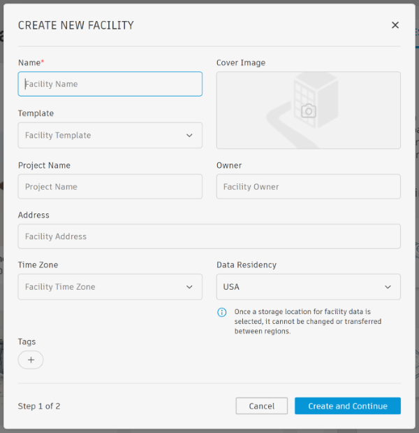

Create Facility
Each time you login to Autodesk Tandem, you are presented with your facilities portfolio. Here you can create new facilities or manage and access your existing facilities.
To add a facility, click Create New Facility and provide a facility name. Providing additional information is optional. If the Create New Facility button is inactive, you may not have sufficient permission within the account and you can work with your Account Administrator if necessary.
Select Facility Template from the drop-down list. You can either use a sample Facility Template or create your own template from the Facility Templates tab under the Manage menu. Additional information that users can include, but is not required:
- Project Name
- Owner
- Address
- Time Zone
- Data Residency
