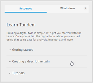

Once a user has created their account and has logged in, they are taken to the Home Page. This is an area where new users can get acquainted with the Autodesk Tandem Interface or use the resources area to learn how to begin using Tandem.
There are 3 main sections in the resources area for new users:
Getting started
- Utilize the sample facility to learn how to create, filter and save views.
- Manage spaces and charts
- View Systems and history
- Digital Twin Building 102 and 201 guides

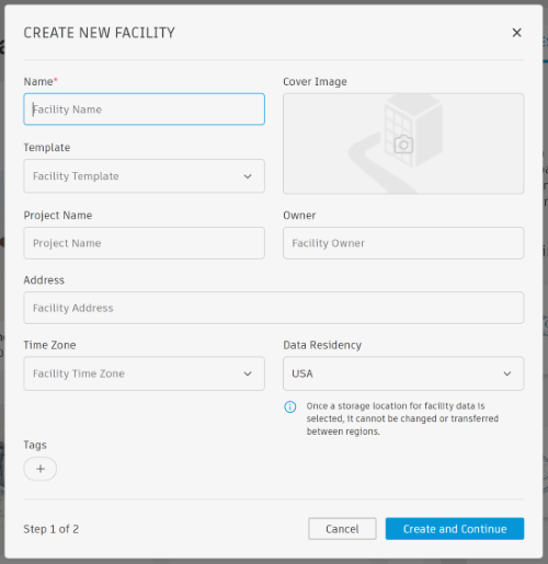

Facilities
From the facilities tab, users can view existing facility or create a new facility using the Create New Facility button.
Once created, users can upload models and begin to configure the digital twin
