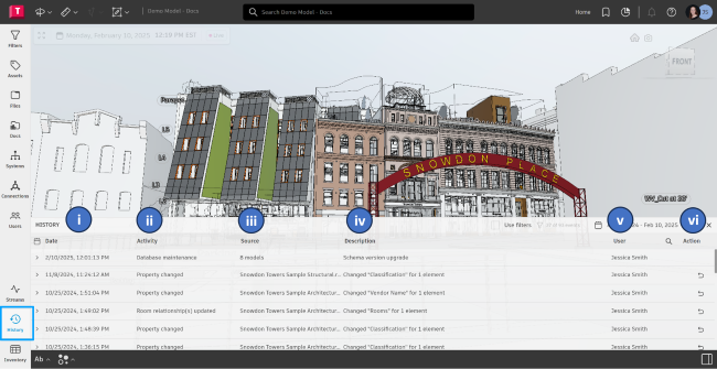

All data contributions within Autodesk Tandem are stored and can be viewed within the history panel. When you open the history panel, you can see a list of events starting with the most current.

    2. Column layout:
      1. Date
      2. Activity (describes the action taken)
      3. Source
      4. Description
      5. User (who performed the action)

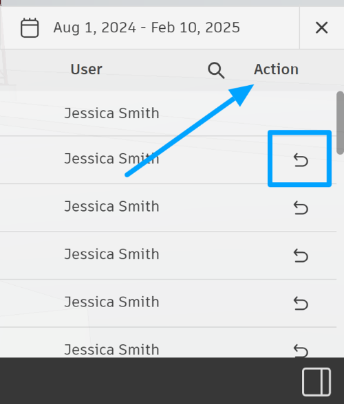

      6. Action (where the Revert option appears)
  1. Identify Changes with Revert Option: In the Action column, look for rows that include a Revert button. Not all actions can be reverted. If a row lacks the button, that action is permanent.
  1. Reverting an Action
    1. Click the Revert button on the desired row
    2. Once completed, the reverted action will move to the top of the history panel, confirming the change.
