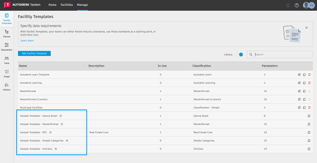

For example, there are three different predefined samples in the Facility Template library for use:
- Simple Categories
- Masterformat
- Uniclass
The templates can be assigned from the library to the Facility when it is created or assigned later.

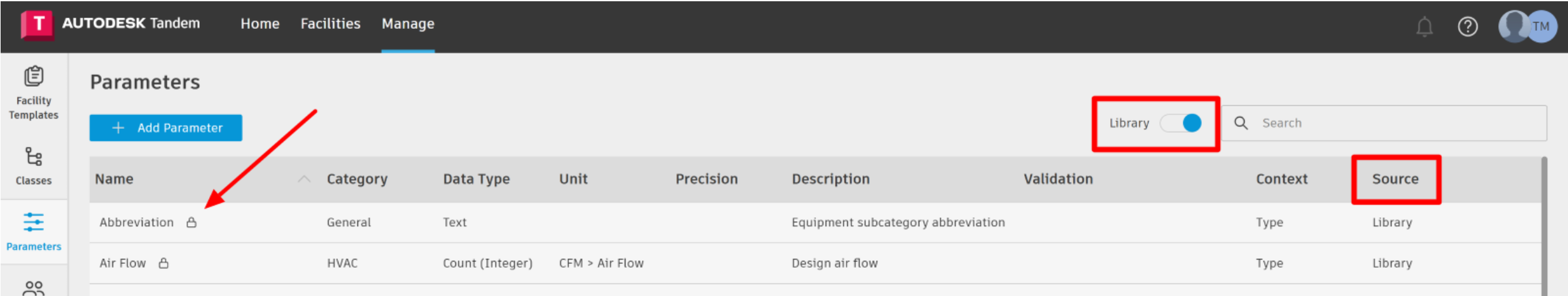

In addition to Facility Templates, a list of predefined Parameters is provided. These parameters are a suggestion, and users can still create custom parameters so the needs of their project can be met.
When getting started, users can toggle the parameter Library on or off using the toggle button. To know what parameters are predefined, there is a Lock logo next to the name of the parameter, and in the Source column (the last column all the way to the right), it will say Library.
