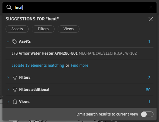

Autodesk Tandem offers an open text box search in the top navigation bar. This feature provides suggestions that can quickly filter the viewer, open previously saved views, find documents and more. The Search functionality allows a user to:
  • Explore the data available for a given facility by any alphanumeric keyword
  • Workflow-specific actions, such as opening a chart for a stream or a comprehensive list of assets in the inventory.
  • Find and filter to content that matches the query - either within a prefiltered view or by expanding the search to discover content not in view
  • View recent queries
  • Reduce the need to rely on the filter panel
  • Quickly discover property data that is available for filtering
To get started, enter the search criteria within the search bar and hit enter.

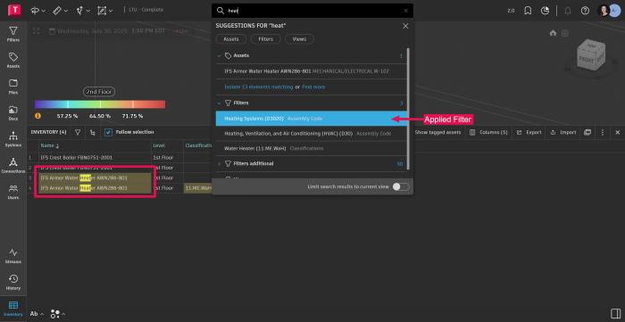

Results will show elements, spaces, parameters, saved views, and documents. Search results can be further refined by selecting the Filters button at the top of the search results. Selecting a filter will open the Inventory Panel and highlight the information that matches the search criteria.
Pro-Tips! When the Inventory Panel is open, search results will be highlighted in yellow.
