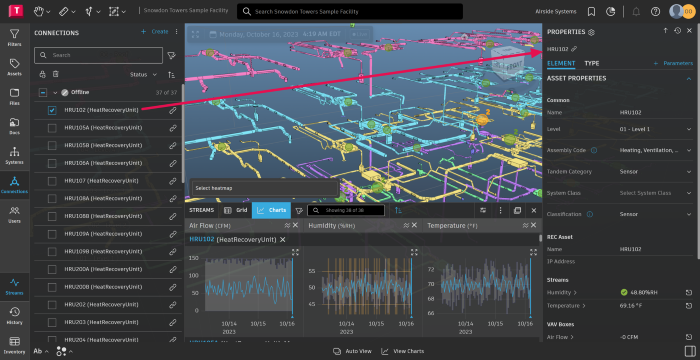

Streams in Tandem are used to display time series data of a connected sensor or IoT device. It can be used in conjunction with the Connections panel to select and display charts for each stream of a connection. With a device selected, users can see more information in the Properties panel.

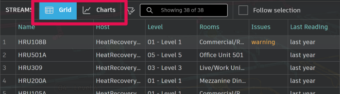

Streaming data can also be shown by toggling between the data Grid and the Charts in the Streams panel. The data grid will show stream information based on the Filters that have been applied.
The grid view displays Stream data in a spreadsheet view similar to Excel. Columns include:
  • Name
  • Host
  • Level
  • Rooms
  • Issues – This will show alerts based on set Threshold
  • Last Reading – This shows the time that data was received by the IoT device and received by Tandem.
  • Threshold Values (if the toggle is checked on)
Users will also see columns for the parameters associated to the Stream and the value of the last data reading received.

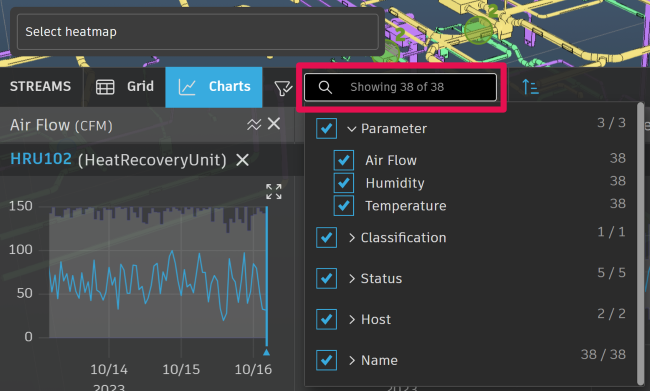

To adjust the columns displayed, users can use the filter to refine the list of charts quickly.

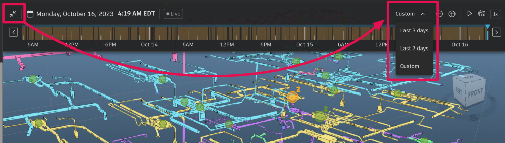

Additionally, the date selector can refine the date range to the last 30 days, the last week, or a custom period.

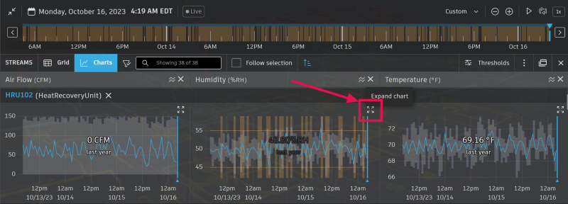

To expand an individual chart use the expand icon.

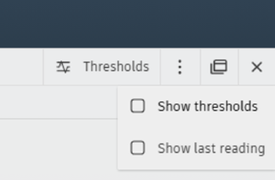

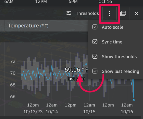

Opening the 3-dot glyph menu, users can also show the last reading that the stream received and threshold lines in the graph.

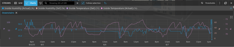

Combined Charts

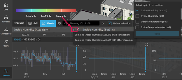

To get started with combined charts, open the Ccombined Ccharts button for a Stream to open the Combined Charts menu. There are two options to choose from:

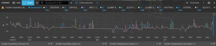

  1. Combine [Stream Name] of all Connections – this combines the same stream across multiple connections.
    Example: Pictured above, Combine [Insider Humidity (Actual)] of all Connections, this will display the Inside Humidity (Actual) stream data from all connections on one chart.
    NOTE: If there are more than 10 connections that have the same stream type, the combined chart will only display the first 10 streams.
  2. Combine [Stream Name] with other streams – This allows users to combine a Stream with other streams from the same connection.
    Example: Combine Inside Humidity (Actual) with other streams by selecting an additional pop-up menu, which offers options to combine with one or more of the other streams associated with the shared connection. In the picture below, we have selected all three of the additional stream options.
