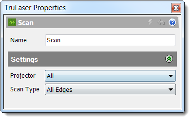

Scans can be added at the group level by right-clicking on a group name and selecting Add Scan.
To define the scan values, right-click on the scan and select Edit Properties.
Enter your settings and click Apply. Refer to the table below for property details.
Name The scan name
Projector The projector associated with the scan
Scan Type The nature of scan such as raw edge, retro target, edge, and other options
