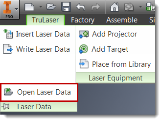

  • Open Laser Data opens the data in a new file. This option appears on the TruLaser tab before you open a file and in the Laser Data drop-down menu once a file is open.

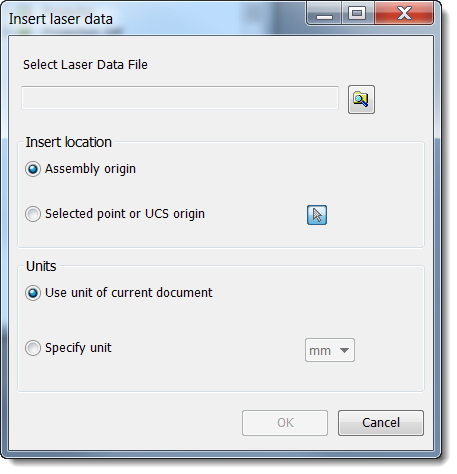

    If you select this option, locate the file to open and select the units of measure.

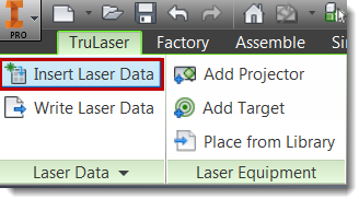

  • Insert Laser Data adds the laser data to an open file.
Data is inserted using the origin of the existing model, unless you opt to insert at the UCS origin or select an insertion point.
