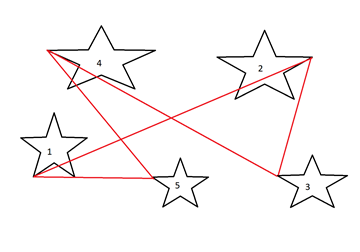

This image is a simplified example of a laser projector's initial path as it moves from star 1 to star 2, and so on:

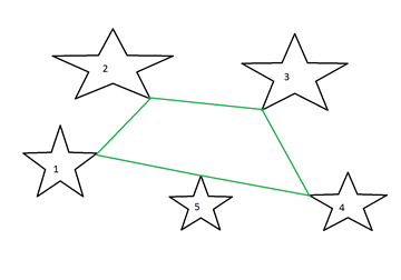

By optimizing laser data, the sequence changes so that the path is shorter and more efficient:
