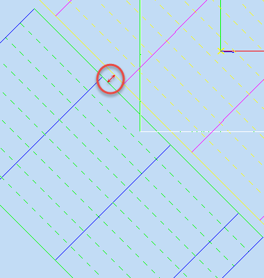

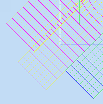

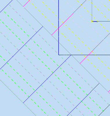

Example: Initial Course offset
Offset the first course from a seed point with a certain value. To make it easy to find the seed point in this example, it is located at the origin point of the red and green rosette.
This makes it easy to compare the position of the first course to the seed point.
  1. In the TruPlan browser, double-click Strategy.2.
  2. In the Strategy dialog box under Course Parameters, set Initial Course Offset to 3.175mm.
    Because the material width is 6.35mm, the Overcore rosette sits exactly in the middle of a tow (between two dotted yellow lines).
  3. Change Initial Course Offset to 0mm.
    The Overcore rosette now sits exactly on the yellow dotted line.

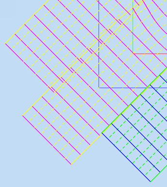

Example: Course Tow Overlap
Forces TruPlan to overlap adjacent courses as they are laid down. This is a percentage value between zero and 100.
  1. On the TruPlan ribbon, click Strategy .
  2. In the Strategy dialog box under Fiber Placement, set Course Tow Overlap to 50%.
  3. Change Course Tow Overlap to 0%.

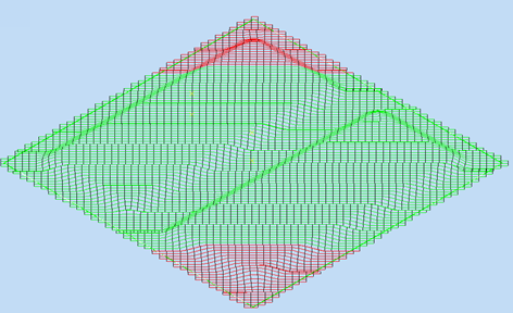

Steering Example

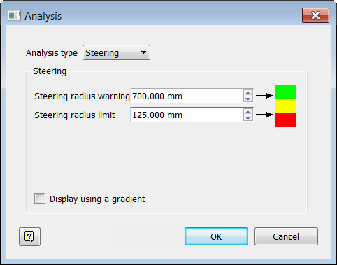

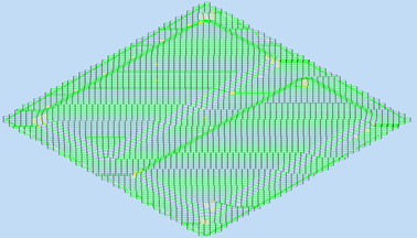

Strategy nodes contain fiber trajectories. Each trajectory is analyzed for in-plane curvature. The limits are obtained from the Steering radius warning and Steering radius limit parameters. Parts of the trajectories are colored green, yellow, or red to indicate whether the curvature is smaller than the Steering radius warning value, between the Steering radius warning value and the Steering radius limit value, or larger than the Steering radius limit value.
  1. In the TruPlan browser, navigate to Ply.2 > Strategy.7 > Analyses.
  2. Double-click Steering Analysis.1.
    The Analysis dialog box opens.
  3. Look at the Steering Radius Warning and Limit values.
Flat areas (large surface curvature) are displayed in green. Areas with smaller surface curvature are displayed in yellow or even red.

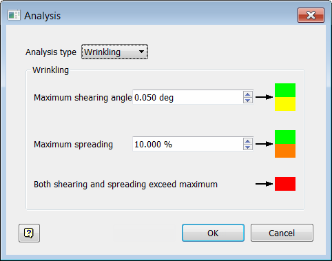

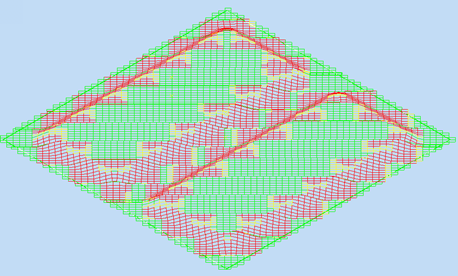

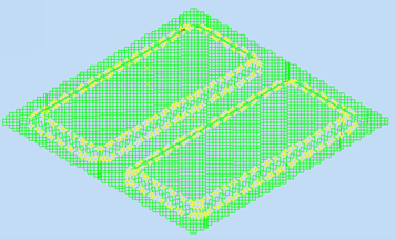

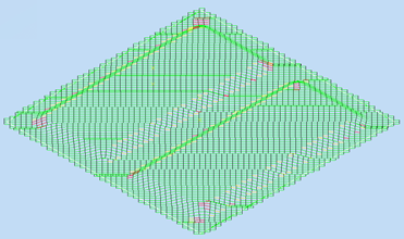

Wrinkling Example
  1. In the TruPlan browser, navigate to Ply.7 > Strategy.2 > Analyses.
  2. Double-click Wrinkle Analysis.1.
  3. Set Maximum spreading to 2%.

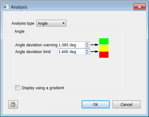

Angle Example
Use this to analyze angle deviation for a given propagation mode. TruPlan calculates fiber trajectories so that the native application (for example, Inventor) can correctly interpret the fiber trajectory and determine angle deviations.
  2. Double-click Angle Analysis.1
  3. Enter these values:
    • Angle Deviation Warning: 1.585 deg
    • Angle Deviation Limit: 1.6 deg
  4. Make these changes to relax the limits:
    • Angle Deviation Warning: 1.6 deg
    • Angle Deviation Limit: 2 deg

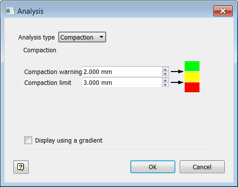

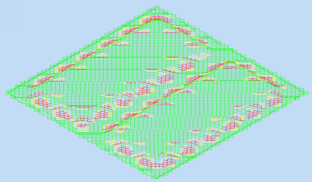

Compaction Example
  2. Double-click Compaction Analysis.1.
  3. Look at the model.
  4. Enter these values:
    • Compaction Warning: 0.1mm
      This is the distance after which fiber compaction affects resin infusion.
    • Compaction Limit: 1.0mm
      This is the amount that the roller can deform/deflect.

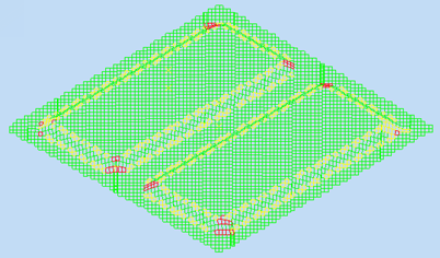

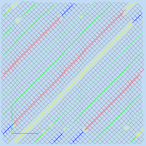

Gap Example
Use this to visualize gaps and overlaps between courses.
Gaps are displayed in green, yellow, and red to show Normal, Warning, and Out of Limit gaps respectively.
Overlaps are displayed in green, cyan, and blue to show Normal, Warning, and Out of Limit overlaps respectively.
Note: Enter overlap values as negative gap values.
To set up the strategy for the gap analysis:
  2. Go to the Placement tab of the Strategy dialog box.
  3. Set Course Offset to 1mm.
  4. Set Optimization to Minimizing Gap.
  5. Set Maximum Overlap to 3mm.
To set the values for the gap analysis:
  1. In the TruPlan browser, go to Ply.7 > Strategy.2 > Analyses.
  2. Double-click Gap Analysis.1.
  3. Set the values as shown.
  4. Click OK.
  5. Right-click the gap analysis under Strategy.2 and make sure that Visibility is enabled.
The resulting gap analysis shows areas of overlap (blue) and excessive gap (red).

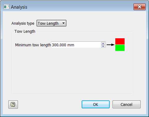

Tow Length Example
Use this to generate fiber trajectories, each of which is analyzed for the length of tows across the ply. The analysis highlights in red any areas that have shorter tow length than the defined value.
  2. Double-click Min. Tow Length Analysis.1.
  3. Set Minimum Tow Length to 300 mm.
    Tow lengths below the minimum length are highlighted in red.
  4. Change Minimum Tow Length to 400in (10160mm).
