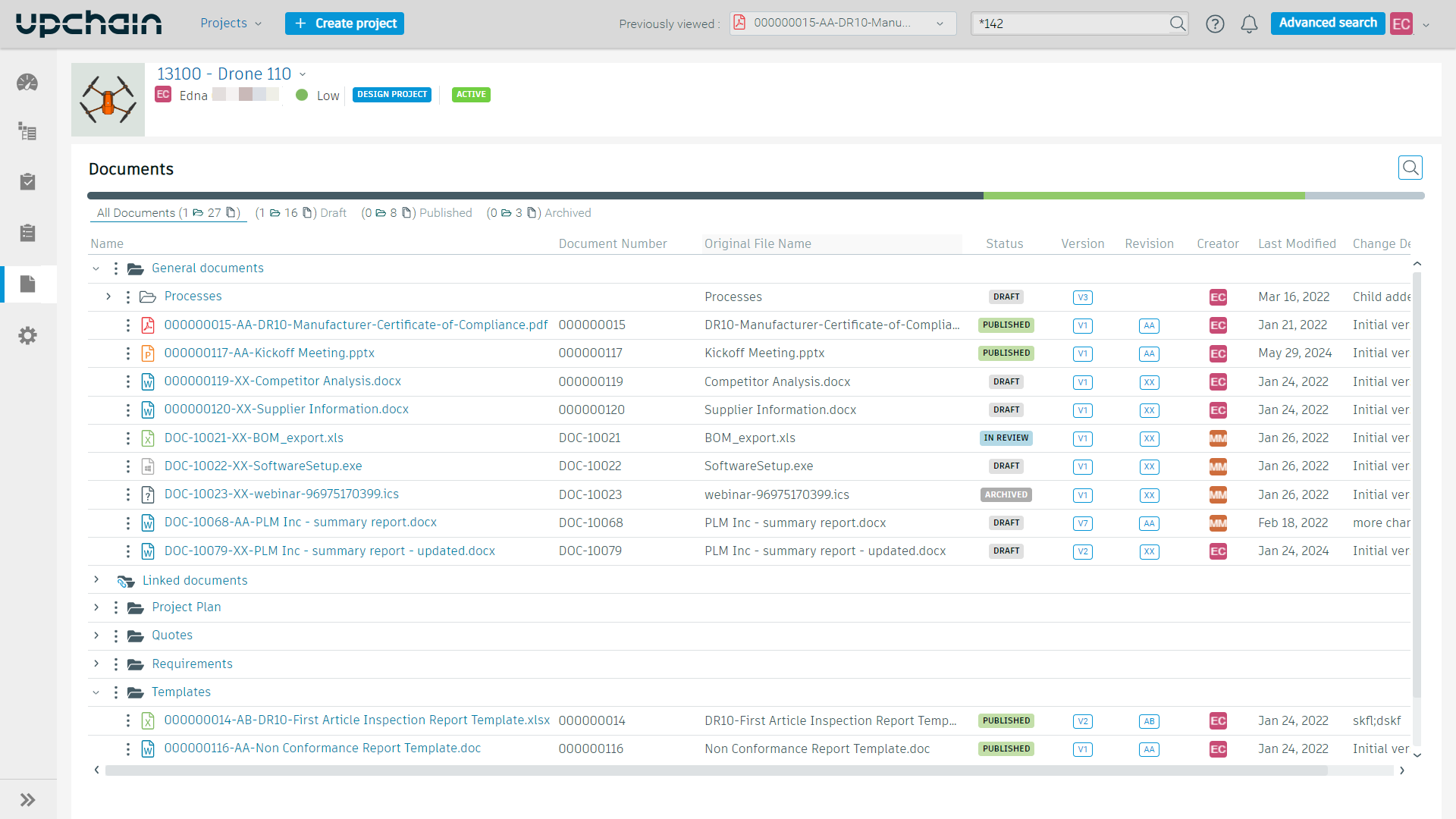

Documents interface overview
The Documents interface displays all of a project’s document categories and a list of documents and folders underneath each category.
Click the chevron beside a document category to expand the list of documents in that category. Document types can be easily identified by their coloured icons. By default, the document table displays the document name, document number, original file name, status, version, revision, creator, and change description, along with the last time it was modified.
Document interface
Note: This image shows Upchain's new theme. Click the chevron next to your profile icon in the main dashboard to open the user menu and select Switch theme.
Click for information on sorting, filtering, and adding or removing columns.
Along the top of the Documents table, you can filter the table to show a flat list of folders and documents with a Draft, Published, or Archived status. The brackets indicate the number of each folder and document with each status.
