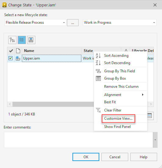

Column customization in multiple dialogs
Customize view functionality is added to adjust the view of the columns in several dialogs (Change State, Change Revision, Change Category, Pack and Go, Synchronize Properties, Undo Check Out). By making efficient use of properties and customizing your view, data management becomes much more tailored to your project.

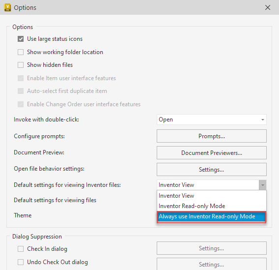

Inventor file view option
A new option called "Always use Inventor Read-only mode" is added to Vault Options for viewing the Inventor files setting. This option is always available regardless of whether the DWF file is available or not.
