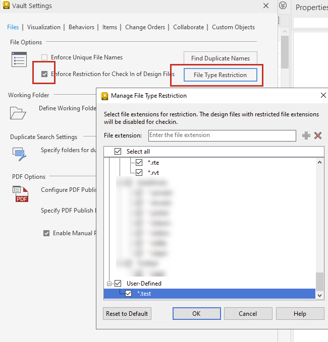

Design file restriction
As an administrator, you can define the list of design files not to be checked in when the "Enforce Restriction for Check In of Design Files" is turned on. You can add the file extensions to the user-defined list but can't remove the system default extensions.
With this restriction, the user can't add restricted files via Vault Client (drag-and-drop or "Add Files" feature). They can only add restricted files using the add-in client for corresponding CAD applications to retain and maintain file relationships.
For more information, see Manage File Restrictions.
