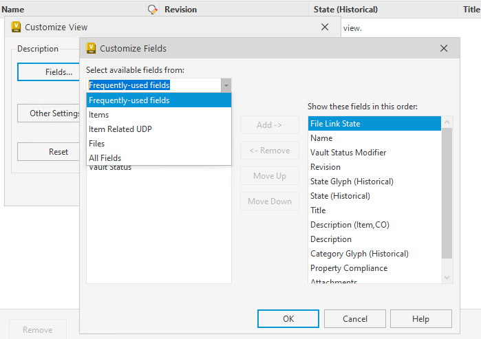

Properties based on object type
The properties (columns) are based on the object type. In some cases the properties are marked (Item,CO) to denote that they are unique to items and change orders.
While selecting the property, select the property type from the drop-down first so that you know what object that property column applies to.
